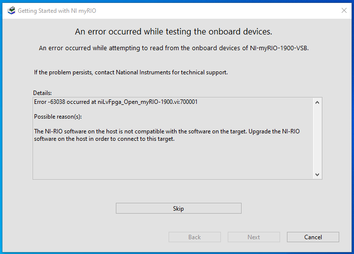

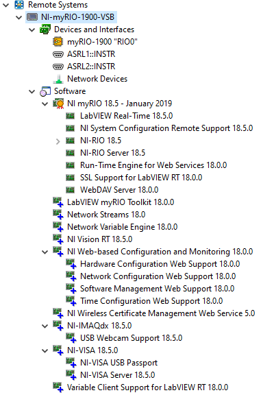

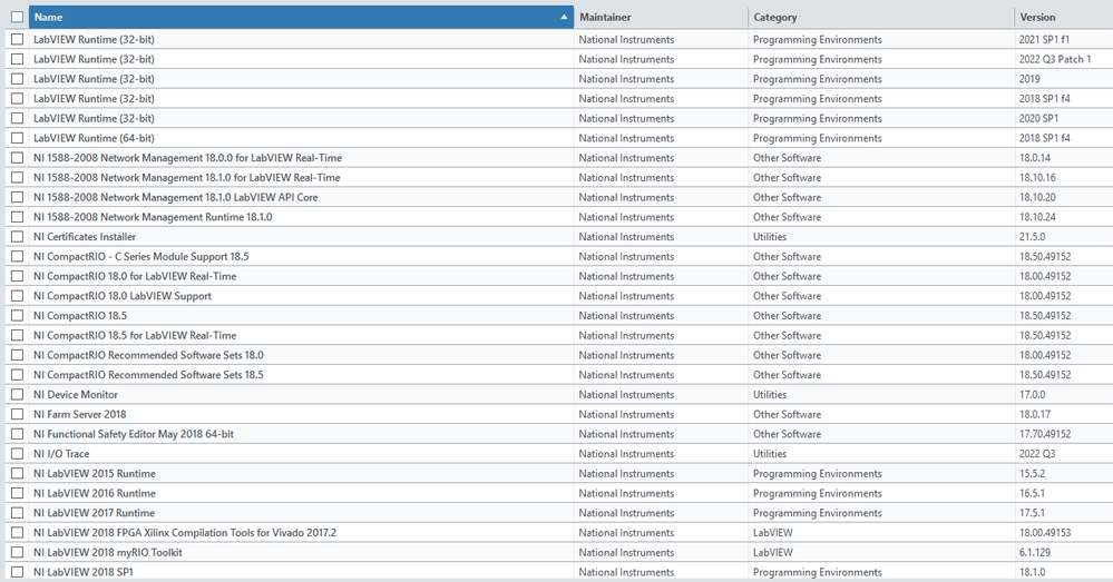

I can't run FPGA on my myRIO. It says error 63038 and I couldn't find a solution anywhere on the internet. I also put photos from NI MAX and NI MANAGER here, the programs should be compatible. Previously, the FPGA has worked. I don't even know what happened and I can't run it on any PC.
I will be very grateful for any help to solve this problem and get the FPGA up and running.
Thanks 🙂
