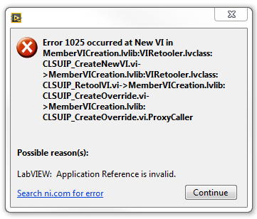

  3. The newest one in the bunch is this: When I create VIs for override after I started LabVIEW it generates two of the override VIs and then Stops with error 1025. After that I can't create any override VIs anymore. This appears to be happening in all my actor framework projects now, but only with the "Actor Core", "Pre Launch Init" and "Stop Core" Methods.

I'm getting the same error in LV2015 when trying to override Stop.VI
Why is this happening to me ?
Started up happening all of a sudden while working of an AF project and now I get an error whenever trying to overide Stop.vi in any new actors in new projects, or old actors in old projects.
Error:
Error 1025 occurred at New VI in MemberVICreation.lvlib:VIRetooler.lvclass:CLSUIP_CreateNewVI.vi->MemberVICreation.lvlib:VIRetooler.lvclass:CLSUIP_RetoolVI.vi->MemberVICreation.lvlib:CLSUIP_CreateOverride.vi->MemberVICreation.lvlib:CLSUIP_CreateOverride.vi.ProxyCaller
Possible reason(s):
LabVIEW:  Application Reference is invalid.
