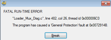

I'm getting a general message error.
Firsteble, I call ndOpenDiagnosticOnLin (19200 baud LIN1)  then ndUDSDiagnosticSessionControl (mode 0x81) then ndUDSReadDataByIdentifier function

I'm getting a general error in the line ndUDSReadDataByIdentifier. (See attached pic)

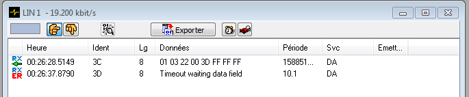

Besides, when I check the Mux Trace to see what the ndUDSReadDataByIdentifier send on the LIN, I see this :
but what I want to send is different. I mean, when i call the ndUDSWriteDataByIdentifier function.
