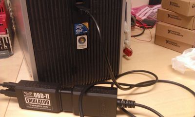

Hello. Thanks for your answer. Yes, I'm talking to a COM port. I used this tutorial: https://knowledge.ni.com/KnowledgeArticleDetails?id=kA03q000000x1qzCAA&l=en-US
I don't use any DB-9 or NI CAN device. OBD-II adapter is connected to USB port on PC. My problem is how to handle this in LabView. Do you have any experience or ideas?
As you see from picture under, the OBD-II adapter is connected to USB on PC and to the OBD-II emulator which is also connected to a computer with a software simulating different parameters.
Message 4 of 12
(16,527 Views)

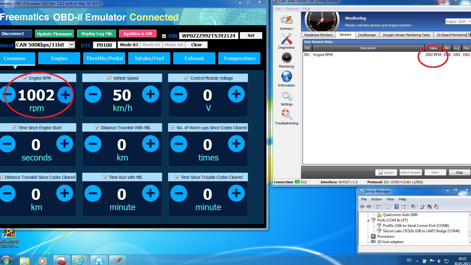

Hello Guys. Thanks for your response. My weekend is close to be destroyed by annoying OBD-II problems..:) I've verified that the drivers are up-to-date and the hardware of the emulator and the ELM327 adapter works well. As you see of picture under, I manage to change values of the OBD-II emulator and register it in real-time with a OBD-II software called OBD Auto Doctor Lite. My problem next is that when I try to read only the ELM327 adapter with a terminal it screws up the keyboard when I put the correct COM-port (COM 6 in Device Manager as in picture) and I can't write commands like for example the "ATZ"-command. If I try another COM port in terminal which is not in use, the keyboard works well! I've tried several terminals like Tera Term, putty, hyperterminal and the same thing is happening to all of them.
I don't understand why I can't read the ELM327 adapter with a terminal when my first setup with the emulator and the ELM OBD-II adapter works. Because it works the port settings should be OK. But I have also used a software called "Scan Tool Finder" which detect OBD-II tool on COM-ports, but this tool doesn't find anything....I hope you can help me guys!!
