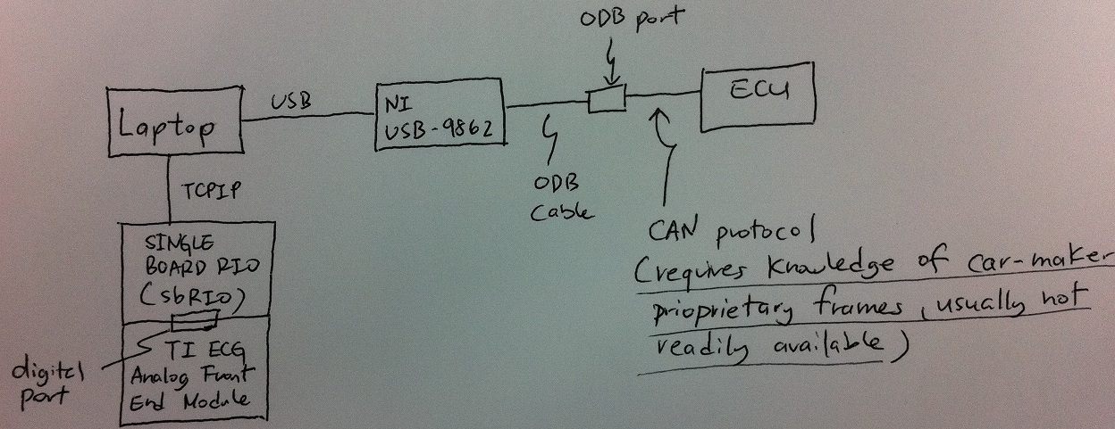

Hi.
I have never actually implemented it, but I guess it would go something like this:
One risk I perceive is the actual communication with the ECU.
My opinion is that without cooperation from an automotive company it will be difficult to achieve.

Thank you for feedback. Also I thought at something like this.
One additional thing I want to know: which are the devices that I need?
I mean, have I need the portable ECG or can I do an imaginary program that can work so that to imagine it is connected to the ECU.
I just want to do a virtual ECG and to imagine some scenarios as it would be in reality.
