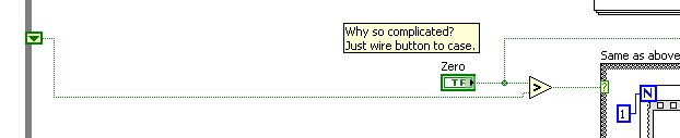

I've only been using LabView for about 8 months, and yesterday I was given another person's code so I can understand it and then make it better/adjust it for our needs. Today I took a closer look and found a bunch of stuff. Being new though, I have to ask is there something I'm missing? Are these old school techniques or is there actually some purpose to these that I'm missing? But anyway, first example:
And yes that is connected to a for loop counter. That's a very common technique in this code. I counted SEVENTEEN buttons that when pressed, activate 1 iteration of a for loop. Why not just use a case structure?
This one confused me so much that I had to make a test program to make sure my logic is right (the boolean wire goes directly to the shift register on the right). So if true, make sure it's not false, and continue. And yes, the case structure activates 1 iteration of a for loop.

For the first, a 0 iteration for loop outputs default data ftor the type of any output tunnels.  I'm not saying that that is why that construct is used but, it is a difference between that and a case structure.
EX 2 is a "Has Changed?" construct. (usually uses a Feedback node for readability and initialization options)  A value changed event and a decient design pattern (P-C-Events) would be more robust usually.
Others Flat Seq Structures are usually for data flow.  Proper sub-vi construction usually makes them less needed but, they are not evil.  Nesting them 4 deep sounds like a maint "Knight"mare.  I hope they are commented.  Be careful what you mean by Parrallel For Loops - Independant loops that are running asynchronus to each other may have uses depending on what they are doing and scaleability of unrelated parameters. (Not saying if that is the case here either.)  Autoindex or wire N is much more common but, there are cases wher you may want to auto-index over a sub-set of an array.
Most likely you ran into code that should be fixed to be more robust, scaleable and readable.  Welcome to our world!  (Yes, I swim it that pool a lot)
