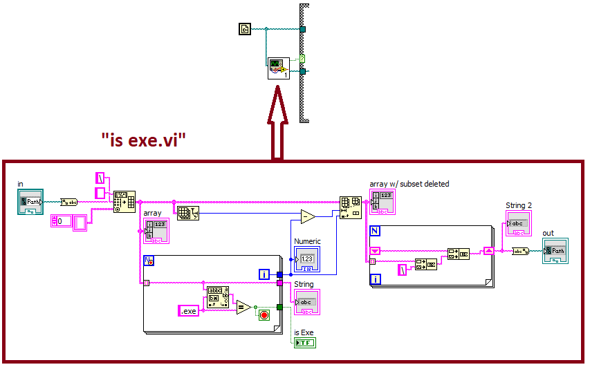

@altenbach wrote:
Here's one way to determine if the current code is run as executable (seen here).
Also that uninitialized shift register would be problematic if run more than once during a session.
I am pretty sure there is a better way!
Also this property node might come in handy http://zone.ni.com/reference/en-XX/help/371361H-01/lvprop/app_appkind/

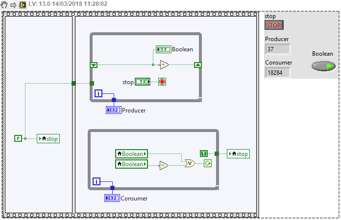

(seen here)
Carnac the magnificient says:  "TRUE & TRUE"
... and the question was: "Is it possible to predict the value of the LED without even running the VI, and if so, what is its value?"
In fact an easier solution would be to just paste a picture of a lit LED on the front panel. No code needed. 😄

@altenbach wrote:
(seen here)
But we can not be sure. What if there are two controls labeled "TT section" ?
Echoing a common theme these days, "show us the rest of the code".
Ben
Message 1954 of 2,635
(11,777 Views)
@Ben wrote:
@altenbach
True in a vacuum, but I checked that before posting. The link has the code and there is only one control with that name. Both equally named locals point to the same control.
Of course if the control changes right between reading the first and second instance of the local variable, we could get unusual results due to race conditions, but my gut feeling is that this is very unlikely. 😄
Maybe we could give these kind of algorithms the name "Hamlet code". 😮
Message 1955 of 2,635
(11,752 Views)
I wanted to ask about race conditions, but I wasn't sure if the compiler would ensure the two locals were read simultaneously.
Obviously not... it doesn't even take very long on my computer. Sometimes it even stops with Producer=0.

I know this is the Rube Goldberg Code forum, but doesn't this prove it as well?
Clicking once or twice stops the loop.
In a realistic loop it won't happen that fast obviously. Adding a 1 ms wait makes it almost (I did not succeed, but gave up after 20 times) impossible to stop the loop.
So it's not RGC at all! It is in fact a (unintentional) "you have to click often and fast" detection...
