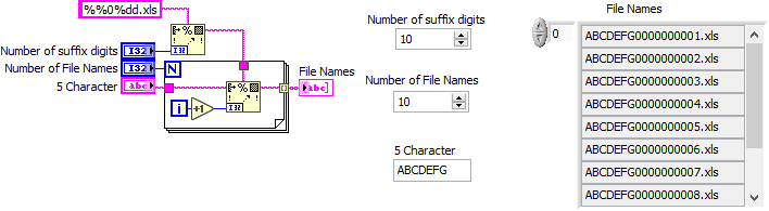

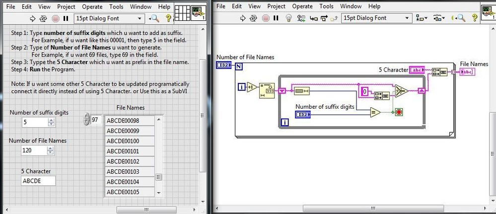

To generate a list of filenames with incrementing suffix, we of course have this function (which gets expensive if the folder already contains a lot of files, different story).
Assuming we want to roll our own, we could do this: (guess what would happen if e.g. "# of digits" = 0 when we call/run it! 🐵
Or we could of course just do the following. Seems easier. 😮
(Personally, I would even omit the +1, because ABCDEF0000000000.xls is a perfectly good file name, but that's just me :D)

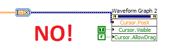

Is dynamic data really the solution for everything? 😮
Some think so!
Of course we cannot wire a 2D array of DBL to a "Cursor.posX" property node for good reason, because there is no conceivable way this would make sense in any scenario. LabVIEW of course will break the wire.
To avoid the broken wire, all we need is convert the 2D array to dynamic data right? No broken wire>>> No problem! 😄 (This is about as effective as fixing low oil pressure by putting electrical tape over the indicator light.)

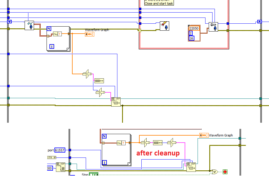

How's that for the ultimate audio compression? (seen here)
So we are reading stereo audio data, concatenate left and right channels into one long 1D array, then all we send over UDP is the size of the flattened string. N bytes to 4 bytes! Seems a little bit lossy... 😮
(Of course things are hard to debug with all these hidden and backwards wires near the typecast, so I took the liberty to also show the same code section after diagram cleanup)
There is something wrong with your cleanup settings.  The For loop grew(should have shrunk and the i term is wrongly placed), wires are on top of each other and the int wires cross twice.  Tell me that was not a Ctrl+U result
