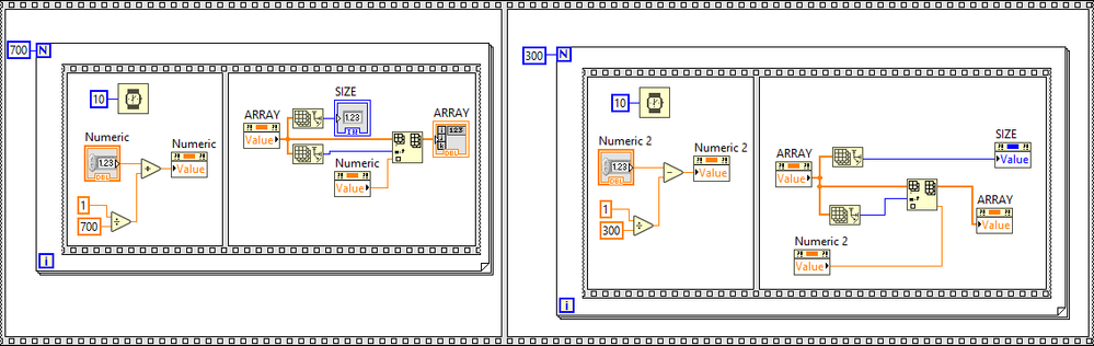

If the programming technique is to add more and more code (and never delete anything) until the output is as expected, we would get something like that:
(Six scalar booleans to six arrays with one element each to six dynamic data wires, joined into one dynamic data wire and transformed back to a boolean array with six elements. 🐵

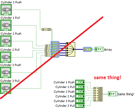

(Seen here)

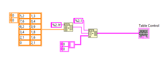

A circuitous odyssey from "array of DBL" to "array of strings" via one long string and some meaningless second format statement:
Could be replaced by a single primitive. 😄

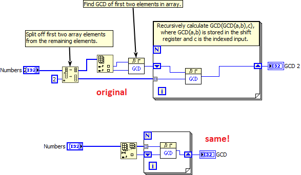

Worse than the classic bundle cluster to array dance because it is an index array, to bundle cluster, back to array Cha-Cha.
Also, just before this some extra code to take any incoming waveform array and delete is all, so that you can be sure to append new arrays to an empty array.
Seen here.

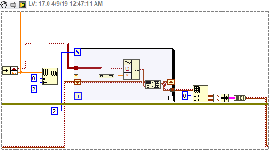

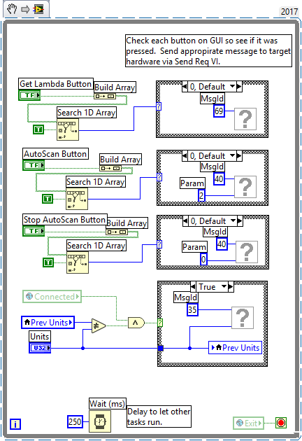

If two functions are near each other (GCD here), it is likely that they can be combined into a single instance. Always worth looking for that possibility:

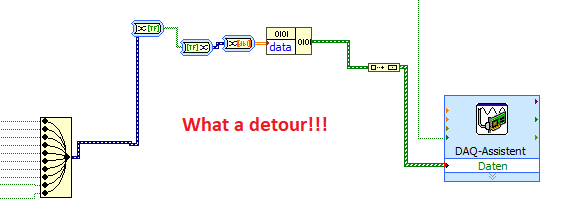

Having a boolean labeled "Start Stop" and some loop termination depending on it set to "stop if true", some set to "continue if true" and some having a "not function" in the wire right before the condition certainly does not result in code that can easily be understood.
(seen here)

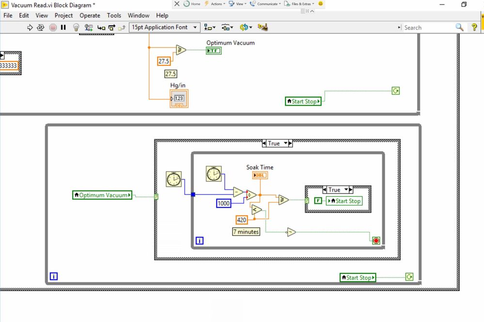

Quite a roundabout way to connect a boolean to a case. Seen here:
https://forums.ni.com/t5/LabVIEW/Save-data-continuously-from-loop/m-p/3939645/highlight/false#M11200...
/Y
