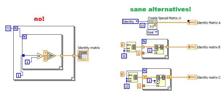

Creating an identity matrix could be done with a stack of FOR loops, where we test in the innermost loop if [i] and [j] are the same and output a zero or one accordingly. (seen here)
Or we could just use one of the sane approaches.
(For a 1000x1000 size, it would mean a million comparisons instead of 1000 replacements. Big difference!)
On a minor side note, I always wondered why "create special matrix" does not have an option to create an all-zero matrix. (easy enough to do using "init array ... array to matrix"), but still seems like an omission. I occasionally need to have an all-zero matrix to initialize a shift register followed by custom replacements of some values. Oh well....
