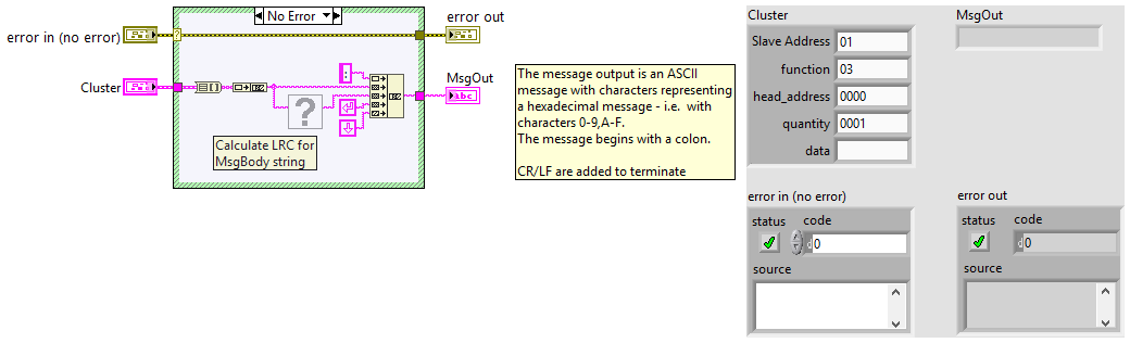

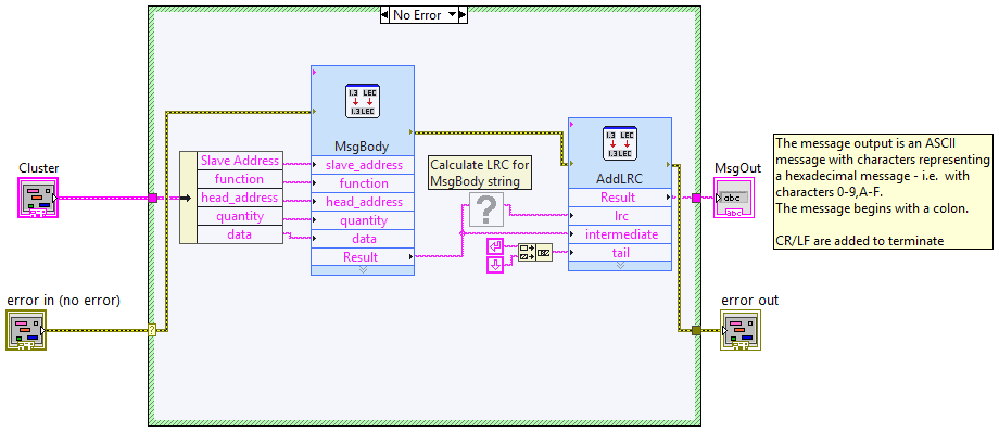

I didn't paint it prettily (you could say neither did the OP in your linked post?) but here was something I found whilst repackaging my code recently...
I'm actually a little concerned that this isn't equivalent to what I replaced it with, since if the Finalize throws an error it will behave differently, but I think for the Finalize to error there would need to be an earlier error anyway. Hopefully I don't discover this was my carefully written workaround to a problem I've forgotten...
And then in another example - RG version
and new version
I added the FP to show that actually I was previously indexing the entire cluster in order. I don't think I knew about the Cluster to Array node when I first wrote this, so I understand that... but an Express VI instead of Concatenate String, sat right next to a Concatenate String?

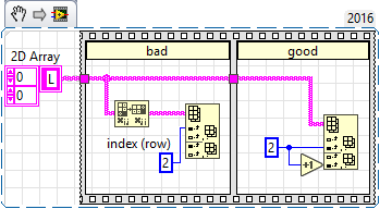

I actually caught a bug in my code last week using the output of "Value Changed.vim" AND TRUE rather than the output of "Value Changed.vim" AND "Value" to detect a F-T transition.  2017
Use Value Changed AND TRUE to detect any value change on a BOOLSmiley Surprised

@jwscs wrote:
my very own (very small) rube goldberg
They are probably about equally good. It is likely that the "transpose" is actually not carried out at all, but the output data flagged internally to index the other way.
Message 1838 of 2,635
(13,113 Views)
in this case i knew about the "its only a flag" thing, but since the index array gave me the "transposed" columns anyway it was really superfluuous

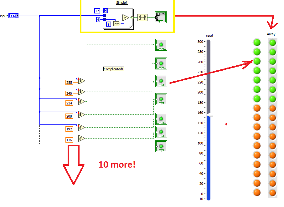

Some people complain that their diagram gets too big, but then they use a screenful of code just to generate an LED level meter. (17 coercion dots, 17 diagram constants, 17 LEDs, 17 comparisons) when all they really need is a small FOR loop the size of a postage stamp and an LED array indicator. The code could even be wrapped into a subVI: I32 in, boolean array out.
(seen here)
