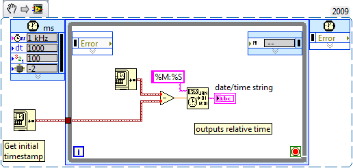

Why are you using a FieldPoint Read to get the timestamp?  You should use the Get Date/Time in Seconds VI:
Does this help?  I feel like the code you have right now may not make the case structure work correctly.
