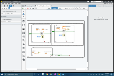

So I have been tooling around with it and so far this is what I have come up with:
So, what I have been able to get to work so far has been the time input and timer count; would like to get it to count down from the entered amount which should easy to do.
Now what I haven't been able to get to work is the tank symbol or even an LED indicator to work properly. The led is on there just to try things out, ideally, the "tank" is what I'm aiming for. In my original code, I was able to get the led to flash on and off.
I.e.
The tank on the other hand I was able to get to add up according to the first counter, but when I go to try and pull a signal off the second time I get an error "to many tunnels."
So, the issues I'm having now:
  • The tank will not register the second(discharge) time. The idea was to increase the bar according to the first then subtract on the second at an appropriate ratio to take it back to zero. Later Ill possibly swap this out with a more animated bar that does the same thing but has bubbles(like this).
  • The counts for a moment show the dec/milliseconds, any way to get rid of this and just show seconds?
  • I don't really know where to start on getting the pop-up keyboard to work, already put one together and found an example of the code/diagram part. I'm just not sure how to link it to the number inputs and have it function as it should. Link to keypad example.
  • Not sure if I should worry about this now or later, but eventually I'll need to have the output signal of the charge and discharge times toggle a physical solenoid, input from a pressure sensor, and above all to have everything function with the desired touchscreen.
