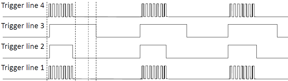

I drew up a schematic of one of the applications I need to get running in our lab. To recap:
1)      We have several piezo controllers for nanopositioning of samples under a microscope, some of them driven by a digital circuit that handles coordinate programming and trigger line programming (for syncing detectors to the piezo motion), other controllers are analog and need to be driven by voltages.
2)      We would like to emulate the behavior of the digital controller using the analog HW (we have much more analog controllers than digital ones).
3)      The basic implementation is like this (see also slide one in the attached pdf file) and runs perfectly:
a.       A global pulsetrain ticks with a certain frequency
b.      At each tick a voltage is written on an AO line and this tick is also sent to an RTSI line to sync multiple detectors
4)      To fully emulate the digital controller we also need to implement 4 trigger lines that exist on the digital controller. These trigger lines allow for fully programmable pulsetrain output that is in sync with the movement of the piezo. Slide two in the attached pdf illustrates what is needed. These trigger lines allow for much more intricate syncing of our detectors (only measure during certain parts of the motion instead of all the time).

Another problem I might forsee with this approach would be that the behavior outlined in my illustartion will repeat many times, there will be 64*64 all the way to 512*512 pixels in my image, so the pattern on the trigger lines need to be repeated many many times. Constructing an array that will hold the whole pattern at once will therefore be either tedious or not practical at all. The masterclock is just a continuous pulsetrain with a given frequency so I can also not have some retriggerable finite pattern on my digital line (unless I use even more counters probably, making things even harder to setup).
Would it be too much to ask for some kind of minimal example in any of the .NET languages (or if need be, in a vi, I could translate it rather easily) that does what I need on an X-series board?
1) One master clock that runs with for example a tick every 200 microseconds
2) One  trigger line that is low the first 100 ticks of the master clock, then continuously high for 128 ticks of mc, then low again for 150 ticks, after which this process should be able to be reproduced indefinitely (mc and triggerline should in essence be continuous pulses). Note that the low time in ticks of mc are not equal before and after high. This would be similar to line 2 and 3.
3) One trigger line that is low for 100 mc ticks, then produces 128 pulses in sync with mc, then low again for 150 ticks. This would be similar to trigger line 1 and 4. Again, this should repeat indefinitely.
mc, and both trigger line tasks should start at exactly the same time so I'll probaly need an additional task to serve as start trigger, but this is trivial and I can surely manage that...
Any help with an example like this would be greatly appreciated!

2)  Counting Trigger Pulse (Counter 1):  This looks like a delayed version of the global timebase with a possibly different duty cycle (from slide 1 of your .pdf).  One of the input parameters when configuring a Continuous Pulse Generation task is "initial delay".  So, you could use a second Continuous Pulse Generation task with the same frequency as the Global Timebase but configure an Initial Delay to allow time for the movement to complete.
3)  Trigger Lines (Counter 4, 5, 6):  Based on the diagram in the .pdf, you should be able to do all 4 trigger lines with just the three counters:
Trigger line 2 and 3 should be easy as far as I can tell, since they look like a Continuous Pulse Generation.
Trigger line 1 (and 4) looks like a faster pulse generation that is gated off of Trigger line 2.  So, you could configure another Continuous Pulse Generation task, but with a Pause Trigger, so that the signal is not generated when Trigger line 2 is low.  You could get by with just one counter for this since it looks like lines 1 and 4 are identical and can simply be split from the same output of the DAQ device.
The key is synchronizing everything so that it starts at the same time.  If you don't have an external signal to do this, you may have to use one of the remaining counters to generate a Single Pulse to trigger all of the counters at the same time. You would generate this pulse after all of the other tasks have started.  There is actually a shipping example that shows how to use a digital start trigger with a continuous pulse train generation which should prove very useful.
One other caveat is the routing on the 6602.  In a sense you can think of the 6602 in two halves--Counter 0:3, and Counter 4:7.  There is a trigger bus that connects the two halves together, but you cannot route multiple signals across halves without having to make external connections. For more information, you can look at the Device Routes tab within Measurement and Automation Explorer.
Granted this might not be as straightforward as opening an example and pressing the run button, but everything should be doable on the 6602 (based on my understanding of the application).  The application would also be doable on most M series and any X series (62xx or 63xx respectively), although it would be achieved in a different manner.  If you run into any specific issues along the way please let us know.  Also please let me know if I have misunderstood any of the requirements.  I hope this was helpful.

In the digital controller I would like to emulate all scans are defined by programming waveforms on the X and Y axes. You just define coordinates for one period of the waveform and it is repeated a user defined number of times. Additionally you are able, for each of the available 4 trigger lines, to tell the controller on which points of the waveform to be high or low and to choose if it should emit a pulse on the trigger line at each point of the waveform or to just stay at a high level for a number of points. This system is quite powerful and allows for doing some pretty cool measurements so I'd like to copy it on other setups.
In the example slide I gave the output is given for a hypothetical experiment where I do a unidirectional scan:
1) The amplitude of the X waveform is 0 for a while to allow the stage to "equilibrate". Then there is a slow rise so the stage moves in X. After that again a resting period and then a fast(er) return motion after which the whole thing starts again.
2) Trigger line 1 and 4 pulse at the same rate as the global pulsetrain because I want a reading for each individual point on the forward scanline. 1 and 4 are low however on the returning scanline because I obviously don't want that data again... I have 2 trigger lines with the same behavior here because there are two detectors (and I am too lazy to split cables). Anyway it is just an example, it could also be that these trigger lines pulse in sync with TimingClock at different moments during the X motion.
3) Trigger line  2 and 3 are level triggers and the keep a shutter in one position during the datapoint recording and in another during the return motion (hence they are level triggers and not pulsed ones)...Again, the times at which they are high/low could be at completely different moments during the X motion, they don't necessarily start at the same time and are also independent of what 1 and 4 are doing. That is also why I cannot use your suggestion to use trigger line 2 and 3 to pause the tasks for trigger line 1 and 4...
Maybe my example was not the best in the world but it all comes down to the fact that I need 4 trigger lines for external hardware that I need to be able to set completely independently of each other but their timebase should be the global timingsource.
I can see how triggerline 2 and 3 are almost trivial to do with my NI board but 1 and 4 are still giving me headaches... this is why I thought I needed X series hardware so tha I could define a sort of "pulsetrain period" that holds moments of low time, moments of high time and moments where pulses are generated and that I could then run continually. Something like that would solve my problem completely. However I have no thourough knowledge of the X series, let alone programming knowledge for this specific type of board, that is why I was wondering if there are examples that do something similar on the X series using it's buffered counter output functionality (if it is actually possible).
I think triggerline 1 and 4 are not doable on my current hardware, lest I add even more counters for various kinds of pause triggers... but that's just cumbersome, not to mention that I'll run out of 6602 boards real quick 🙂
