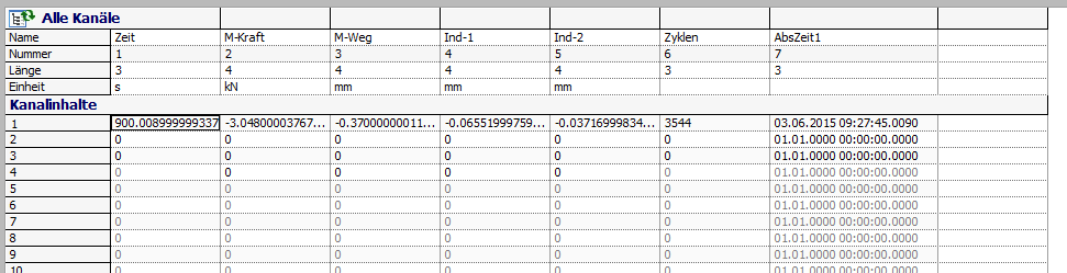

No logfile is created. It even works to read the *.tdm file, but it contains no data.
  • What does it contain

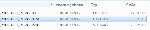

I have the following Files:
The size of the TD01 File indicates that there is data, but I can't acess it.

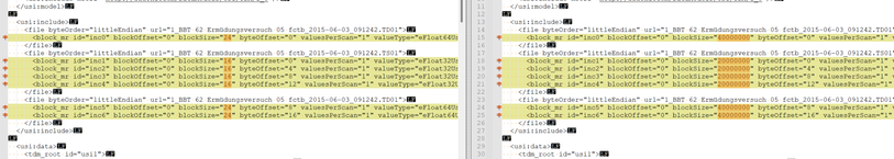

What you found is an error related to the "Kanalorientierte Speicherung" in DIAdem DAQ.
I have attached the corrected header that should be able to load the binaries correctly.
The blocksize in the TDM header is accidentially set to the expected channel lenght instead of the binary block size.
To determine the correct blocksize the byte length of the values in a single file needs to be determined.
In your example :
40000000 => 8 + 8 + 8 = 24 (3 float64 values) ;
20000000 => 4 + 4 + 4 + 4 = 16 (4 float32 values)
If such crashes occure often in an environment I would suggest to switch The "Channel oriented" mode off as a workaround.
Sorry for the incovenience.
Andreas

It is the TDM XML file that has been adjusted.
Here is the compare from the TDM header in the thread.
