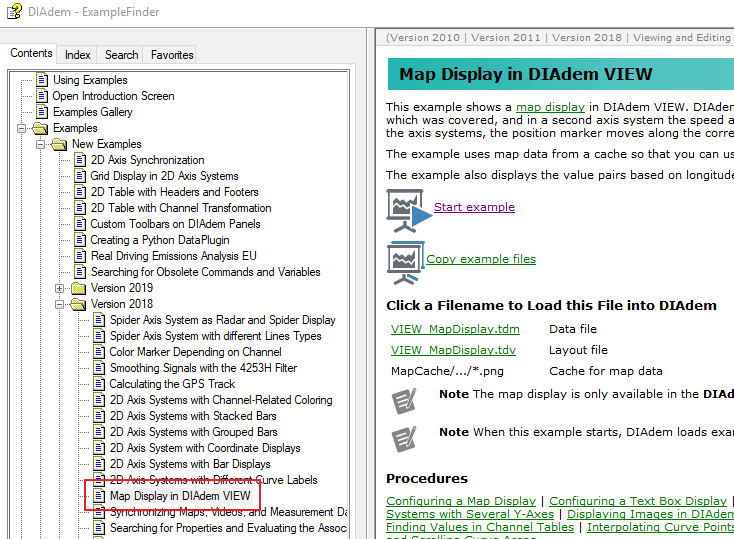

I have these channels. Time, Speed, Latitude, Longitude. I can draw the GPS map by assigning the latitude-x and longitude-y.
However, I want to follow the map with speed. When I assign the latitude and longitude channels, in this situation, I have no time value on the graph, hence I cannot follow the map.
Probably I need to assign time to x-axis, latitude to y-axis and longitude to z-axis. Is it possible to do this on Diadem Display?

Hello mmt1357,
Please have a look at this example:
Greetings
Walter
