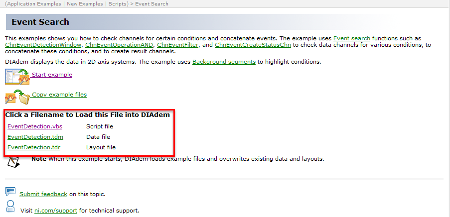

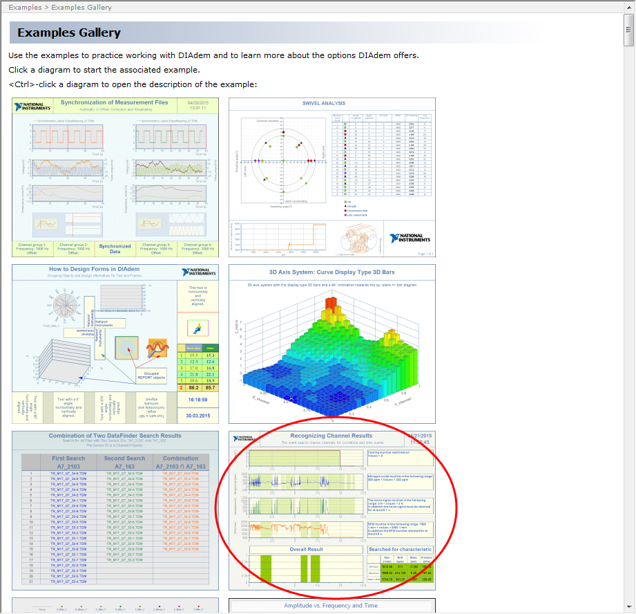

DIAdem 2015 has introduced the Event Finder functionality in the ANALYSIS panel.
The example called "Event Search" in the examples gallery shows how the use that function:
If you hold CTRL while clicking on the example image you get to the files that make up the example:
The VBS (Visual Basic Script) file associated with this example shows how to use the "ChnEventFilter" feature of DIAdem to detect the duration of an event.
Please have a look at the example, check the VBS file for the code and I think you will find the answer to your questions.
