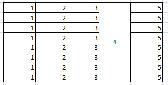

I have a report where I have a table with multiple rows and columns and I was wondering if there is a method where columns 1, 2, 3  & 5 have 5 rows but column 4 has only one cell that spans the entire physical distances as rows 1 - 5 of  the adjacent columns 3 & 5.
See below

Hi Tim,
Nope, as of DIAdem 2015 this is not possible with 1 table.  Your workaround is to create 3 tables and place them perfectly next to each other.  Note that now in DIAdem 2015 you can group REPORT objects together-- this makes it easier to manage such workarounds with multiple components.

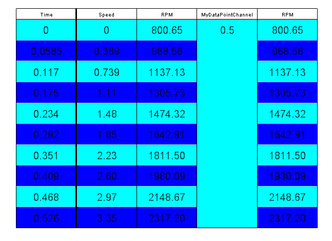

Tim,
I have been playing around in DIAdem 2015 and have not been able to configure a table (using either the table configuration window or a VBScript command) in the exact manner you mentioned.
The closest format I have identified is in the below image. To get this configuration, turn off the 'Separator between the rows' option in the table's 'Display' options. You can then add a 'Background color' and an 'Alternating color'  in the table's 'Display' properties to simulate the horizontal lines removed (color striation). You can then go to 'Column Properties', choose your single-value channel, select 'Display', and give it a background color.
Note, I did not find a method for vertically centering that single data value. Hope this helps!
Cheers,
Quentin Smith
Applications Engineer
(5,568 Views)
