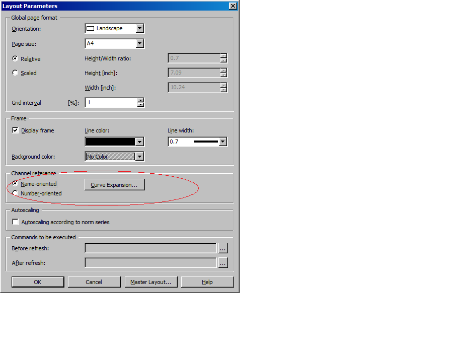

On the report tab go to settings >> Layout Set Up >> Layout parameters and I believe you change channel reference there as well

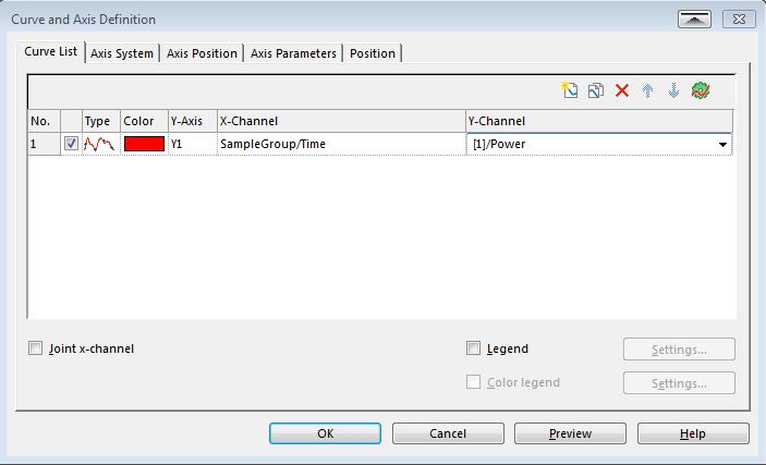

You should also be able to just type the channelgroup/channel names in the curve definition area on the report. This will save with the report template as with other report settings.
