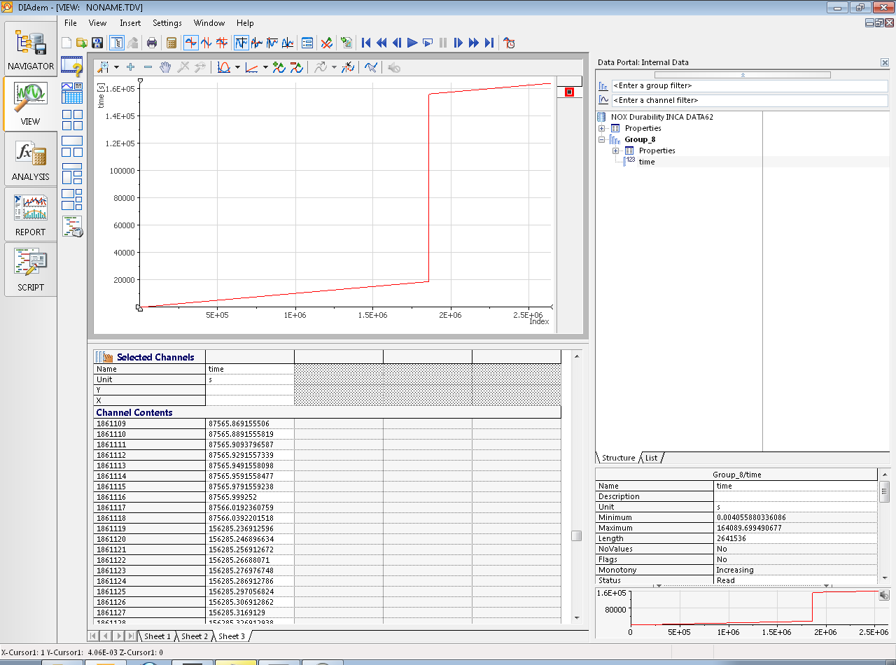

I have a time channel that has an unexplicable "step" in it.  I'm going to blame it on sunspots...  Anyway, for some reason, my measurement system has a big jump in the time channel, which is ruining some analysis.  I have about 40 different explicit time channels, and only some of the exhibit this problem.  Please take a look at the attached screen print to see the problem.
I can't go back an collect the data, so I need to fix the time channel as it is now.  Any ideas how I can fix this?  The data is explicit, so I can't create an implicit time channel.  Basically, I need to offset this particular time channel starting at row 1861119 and later.  Since I have so many time channels to check, I would like to create a script.  I will also use the script in the future to automatically fix this, if it should happen again.

Hi Mr. Spark Plug,
We can help you achieve your goals, but you need to provide more information.  You can run a script to check the elapsed time between adjacent values in the Time channel and look for any delta time values greater than a certain allowable threshold to detect these unwanted sunspot events.  What would be that threshold delta time value?  Is it a static value or something dependent on the average delta time in the data file, or what?
Once detected, the script can shift the values in the time channel after the sunspot event to make the large delta time sunspot incident into a reasonable delta time value.  So, what would that reasonable delta time value be?  The same as the previous or subsequent delta time?  The same as the average delta time in the time channel, with or without the sunspot jump?
Would you ever expect more than one sunspot event per time channel?  Or would you be willing to run the processing script multiple times if there are multiple sunspot events?

Hello Brad, we are collecting the data at 100hz, but it is an explicit time channel with data collected from a CAN network.  So, the time stamp deltas can be as much as .2s.  I would think that anything over 1s would be a good delta to use.  So far, I have only seen ONE sunspot event per time channel.  I hope it doesn't happen again, as that would mean I have bigger problems. (Have you ever seen anything like this before?  I can't imagine what would cause this to happen)
The shift in time after the sunspot event should have a value of 0.01s + the time stamp just prior to the event. So the reasonable time would be 0.01s.  This should get the channel back to a reasonable state. So if the values are 1.2258, 1.2347, 5.6743, 5.6878, they should become 1.2258, 1.2347, 1.2447, 1.2582.  Notice that the delta between value 3 and 4 is maintained.
This is IMPORTANT, the delta between all the values needs to be maintained, with the exception of the delta between the first pre-sunspot value, and the first post-sunspot value.  Does that make sense?
Thanks for the help.
