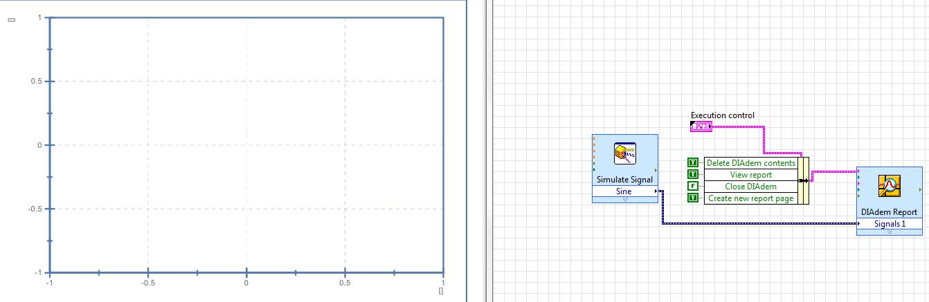

please try the default settings of the DIAdem Report VI like this:
(Set Built-in layout template to "XY Graph (landscape)")
Result: myReport.pdf => LV 2012, DIAdem 2012 SP1 both english version
Does it work?
When not please start DIAdem and try again.
Please also try the following modification of "lv_diadem_01.vi":
(The option "Delete DIAdem contents" is initialized with "true")
My result pdf is similar to the screenshot above.
Does it work on your machine?
Message 24 of 25
(3,156 Views)
Hi, it doesn't work.
