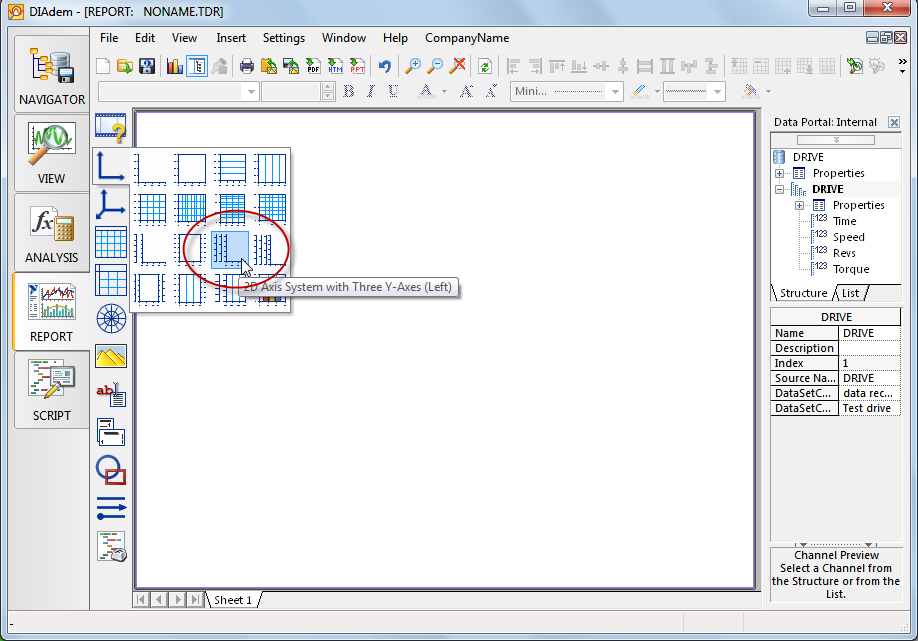

Hello dsasorin,
Just a few hints that I hope will make this easier for you:
In REPORT, select the "Multiple Y-axis" templates for 2D axis systems (see image below for 3 Y-axis, it's easy to add more if needed):
