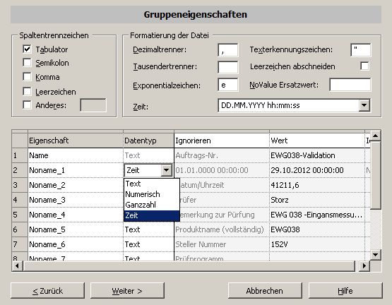

Most of the header names and values are read in correctly. But not line 2, "date"<tab>"dd.mm.yyyy"
Step 2 of the DPA gives the following:
When ignoring the property name, I can set the value type to "Time" and string "29.10.2012" is read correctly as date 29.10.2012 0:00:0000. But I loose all the property names.
When I choose to use the first string as name, the type selctor is greyed out and the DPA insists on reading "29.10.2012" as numeric. So it reads 29.1 cutting off trailing zero and all beyond.
I tried to edit the txt-Pludin.VBS but I don't see the point where to make the script read line 2 as date.
