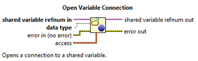

You can use Open Variable Connection.vi to open the variable once upon startup:
I guess the question is why you use the explicit VIs like this rather than just placing a shared variable on the block diagram?
