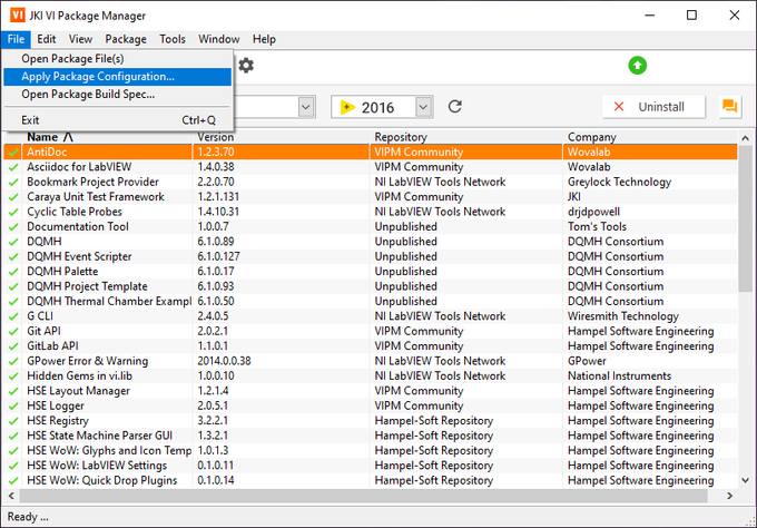

VI Package Manager is a product provided JKI (i.e. it is not a product of NI and it's not installed together with LabVIEW). See also this NI Help page. You can select during the installation of LabVIEW if you want to install VIPM (the option is checked by default)
Assuming the installation of VIPM is corrupted, can you download the installer at vipm.io/download on a different computer and then copy it to your LabVIEW PC to reinstall?
Edit: Corrected some wrong information after talking to Fab. If you have VIPM installed correctly, please try opening VIPM, and select "Apply Configuration..." from the File menu, then browse to and select the downloaded .vipc file?

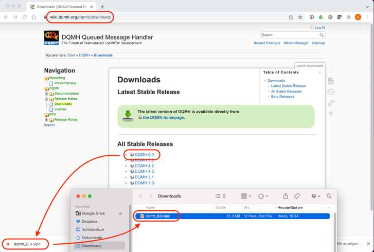

If you go to https://wiki.dqmh.org/dqmh/downloads you should see the list of releases.
The link to DQMH 6.0 is https://dqmh.org/download/454/ and it should download a file by the name of dqmh_6.0.vipc (31.3 MB). This file is the configuration that VIPM should apply.
Can you repeat these steps on your system? Does it look differently?
