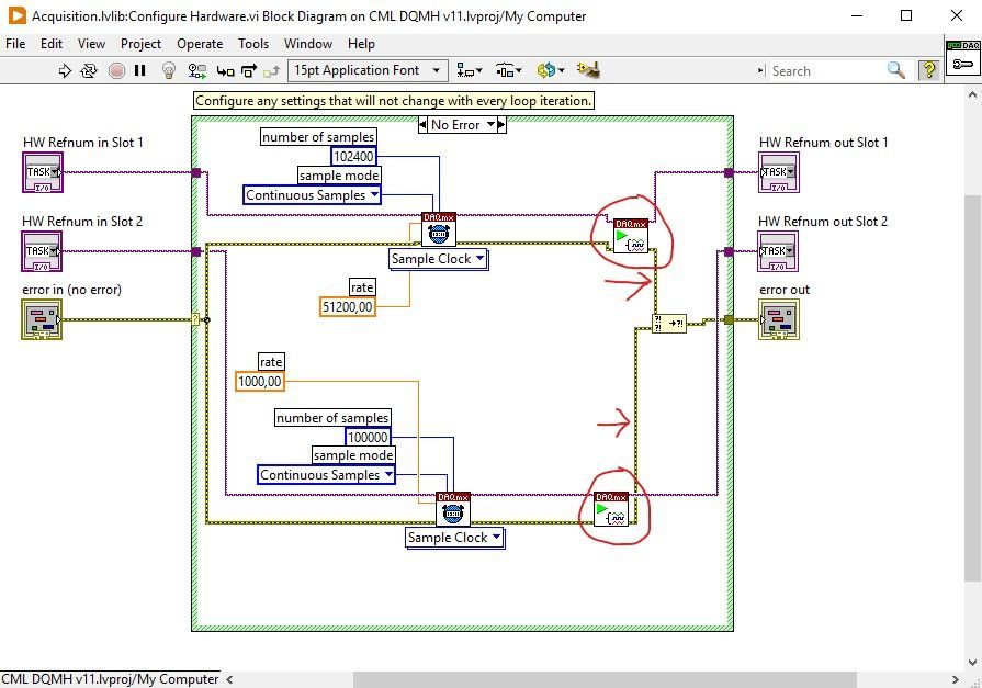

since the acqusition is now working with my NI-9234 (in a NI-9185 chassis), I wanted to add a second card (NI-9215) and acquire signals as well (all with the DQMH CML Example Version 6.0).
In the Acquisition module, I changed the data cluster to have a second "DAQmx Task Name" (the first for my 9234, the second for my 9215).
But I do get an error, happening whithin the "Start Acquiring" case in the "Configure Hardware.vi":
Both my "DAQmx Start Task" fail with the following error message:
Error -50103 occurred at DAQmx Start Task.vi:7220002
Possible reason(s):
The specified resource is reserved. The operation could not be completed as specified.
Task Name: _unnamedTask<33>
I am not sure what I am doing wrong here, since I have those two "DAQmx Start Task" in parallel in other code as well. What am I missing?

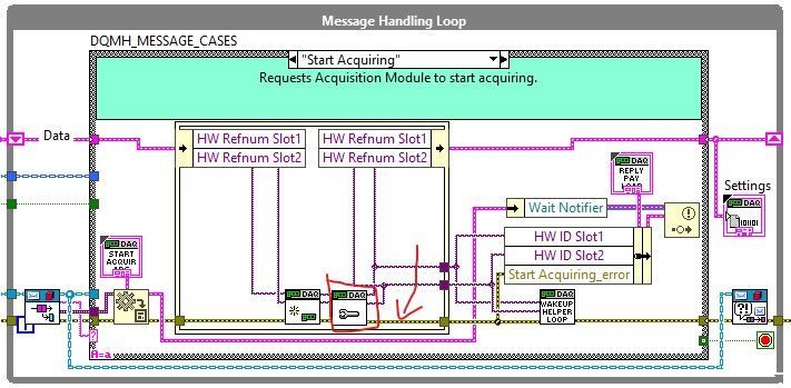

Yes, it goes from most recent to oldest, so if you start reading from the bottom, you see the error starts at #5 in "Acquire.vi", with additional information to look in the helper loop. Now, I don't think there is any problem with the Acquire.vi, but take a look at how you wake up the helper loop, and see if anything needs to be changed now that you're using 2 DAQ tasks instead of 1 🙂
(2,027 Views)
Oh my goodness, HOW could I have missed that. It is so obvious. Of course I forgot to update my "Wake Up Helper Loop" with the second DAQ Task.
Thank you for pointing that out. 🤗
