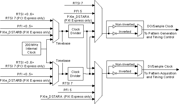

I cannot delete the post I wrote this morning, but after some reading I guess I am still wrong.... Smiley Embarassed
I have an hardware clock coming from my electronic board, generating the number of sample I want which has to drive the acquisition of data on Dev1/port1.
The first question regards the routing.
Can I route a signal coming from Dev1/port2/line3 to PFI5?
By looking at the "Device Routes" in MAX, apparently I cannot do it, because I have not explicity found the route, but I found I can use RTSI7 as an input clock to route to PFI5, and then Dev1/port0.
Of course, I did not know what was a RTSI and I had to get more information.
The second question is: If I cannot directly route Dev1/port2/line3 to PFI5, and I have to use RTSI7 do I have to physically connect a wire between my electronic board and the pin 34 (see table below)? [It is not a problem because I can do it]
Third question: do I have to add and configure RTSI7 (which it appears as RTSICable0) in MAX?
And finally: when I am importing my hardware clock and using it on RTSI bus, does it interdict the onboard clock?
Clocking Block Diagram
RTSI Bus Pinout for PCI boards: Pinout for AT boards:
RTSI_OSC (clock) 34 1
RTSI 6 32 3
RTSI 5 30 5
RTSI 4 28 7
RTSI 3 26 9
RTSI 2 24 11
RTSI 1 22 13
RTSI 0 20 15
Not Used 1-18 (all) 17-34 (all)
Ground 19-33 (odd) 2-16 (eve
Sorry for previous morning posts I have been shallow
Many Thanks
Carlo Alberto

Hi Carlo,
Unfortunately, it is not possible to internally route a data line to the clock of the 6535.  Ideally, you would have a breakout board (such as a CB-2162) that would allow you to manually connect the line your clock is on to PFI 5 on the connection block.  I'm unsure how you interface with your DUT, but if it is straight to a VHDCI connector, that will mean a major modification would be necessary on the DUT side to get that signal over to PFI 5.
RTSI, as you probably know, is the 34 pin connector on the hardware itself that is intended for synchronizing multiple PCIe boards together.  Those lines do have access to the clock circuitry, and if you can find a way to route your DUT clock signal to that line, then you can route it to the internal clock circuitry on the 6535.  This is not a supported method for importing a clock, and I would still recommend trying to go through an accessory, but it may be easier for your application somehow to route the signal there.  You would need a physical wire to go from the clock to the RTSI 7 line.
Kyle A.
