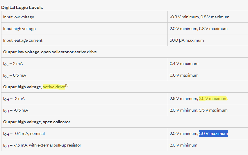

No, you cannot control the output voltage level of 6501. None of the NI DAQ DOs have the feature to control the output voltage level internally.
You can use an external level shift circuit to bring it down to 3.3V logic. For example - https://learn.sparkfun.com/tutorials/bi-directional-logic-level-converter-hookup-guide/all

Note that 6501 has two different output modes, based on the mode the output voltage differs. In active drive mode, the max output voltage high signal is 3.6V.

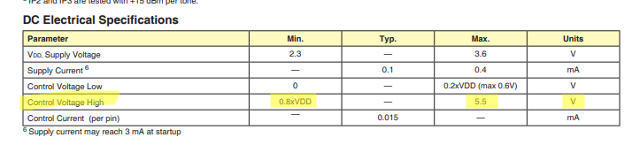

Actually, I newly use these kind of devices. I will connect USB-6501 to Dsub connector to RF Switch(ZSWA4-63dr+, Minicircuits). Thank you for your understanding.
I think I should study about that "active drive mode" and level shifter. I haven't known the level shifter yet.
Message 9 of 13
(1,606 Views)
Actually, you don't have any issue, the switch support digital logic signal up to 5.5V irrespective of VDD.
https://www.minicircuits.com/pdfs/ZSWA4-63DR+.pdf
You can directly connect 6501 with the RF switch.
