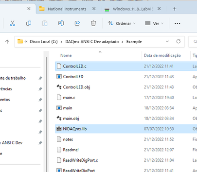

This is a tutorial to control a LED using ANSI C with NI hardware:
1. Compiler used: cl from (Microsoft using VS Build Tools 2022- not necessary login - no IDE);
2. Library: NIDAQmx.lib;
3. Example of compiling (with include) and linking (in conolse: x86 Native Tools Command Prompt VS 2022):
      cl /EHsc /MD /I "C:\DAQmx ANSI C Dev adaptado\include" ControlLED.c NIDAQmx.lib
4. Put all files in same directory: NIDAQmx.lib and ControlLED.c;
5. It is mandatory to install the Drivers;
6. Obviously, see some examples of LabVIEW ANSI C (coming from NI);
7. Hardware used: NI USB-6009, you can use another;
8. Enjoy! And Have a good job; 🙂
