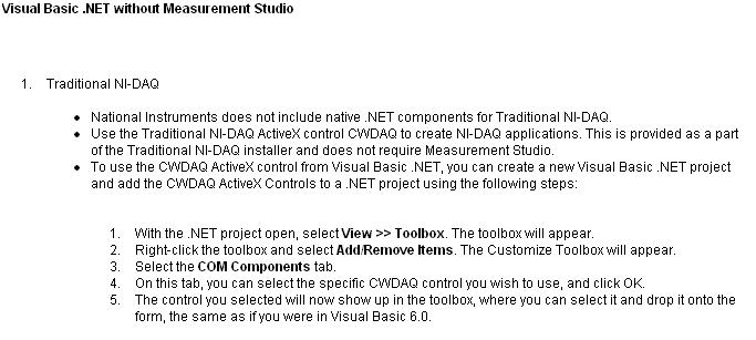

It is possible to program Traditional (Legacy) NI-DAQ with .NET, though it isn't the best solution.  Check out this KB:
Programming NI-DAQ in Microsoft Visual Basic .NET
-Alan A.

The best reference is just a snippet from the KB I linked previously:
Additionally, I would like to mention that you might want to consider upgrading your hardware to a device that is supported by NI-DAQmx.  There is native .NET support for NI-DAQmx, and there are also tons of shipping examples that install with NI-DAQmx.  It really might be worth the $ to purchase a device that can be used with NI-DAQmx.  Some PCMCIA options include the DAQCard-6024E, DAQCard-6036E and DAQCard-6062E.  There are also some portable USB options as well:  DAQPad-6015.  Just my two cents.  Hope this helps!
-Alan A.
