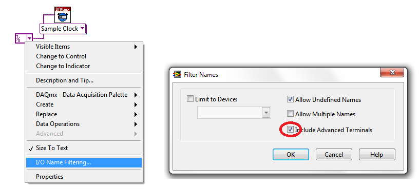

Hi Drew,
You should be able to right-click on the DAQmx Terminal constant or control and select I/O Name Filtering.  Then check the "Include Advanced Terminals" box.  This should now populate the list with many more options, including the Internal Outputs of the Counters.
Of course, there's also not a problem with routing the signal back to the DAQ device with external wiring.
For a full list of available routes, you can check the Device Routes tab in MAX.
