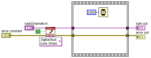

I have a NI 9472 with a solenoid valve attached. I developed a simple vi to actuate the solenoid valve (normally closed) when a pre-set pressure (i.e. voltage) is reached, i.e., the valve opens when the pressure exceeds the setpoint and closes when it decreases below the setpoint.  However, what I actually want the vi to do is to keep the valve open for a certain amount of time (say 1 sec), so that the pressure built-up can be fully released before the valve is closed, so then pressure is built-up from zero again and the cycle is repeated. I read some threads already but I haveen't found a answer that works for my application. Thanks for checking and looking forward for your help!

It's hard to be certain without knowing exactly how your code works, but you may be able to use a Wait(ms) vi in your code.

without looking at your code, you could do this...

Sorry, I should have included my vi (see attached).
The vi works such that when the voltage (controlled by a knob) reaches the set point, then the valve is opened. However, I don't know how I can keep the valve open for a 'certain' amount of time, regadless the voltage goes back immediately below the setpoint. This is to ensure that the pressure is fully released when I implement my real application.

try this...make sure you put a wait function in your loop, otherwise you are using 100% of your CPU

Hi Apok,
That works! I'll try it with the pressure system and let you know how it goes.  Thanks!
