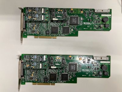

I have a PCI-6111 coupled with a E5500 phase noise system. When the phase noise measurement software is opened an error message of -10608 will display and will not allow for testing further - this also happens at random it seems, meaning one day it'll be fine and then the next day it won't work at all. We have swapped in another card and the results seem to be the same. So far I'm leaning towards it being the computer itself causing the issues but was hoping for another piece to possibly look at.

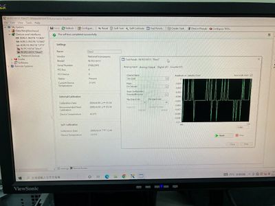

Swapping in a new card has fixed the issue for now, believe there to be an issue still just hasn't presented itself yet.
Please note, we had swapped in another PCI card prior to this one and had a similar result of our system working, however later on having the same failure as the first PCI card. Either way I'm in belief that there is some sort of communication error for the input side when these errors present themselves.
