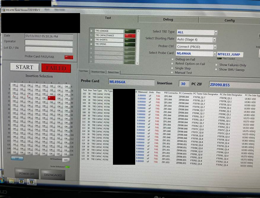

Hi~
We have two PXI-1065.
one of them run perfectly in same condition.(same wiring, equipment, ProbeCard, and etc.)
We do not use probe pins just connect with cabels.(probecard and PXI.)
We do not use Wafer when we do relay test in probecard.
If you have any question or wondering just let me know I will explain more.
Thanks.
measurement_0measurement_0

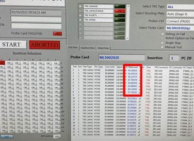

Hi~
I already changed the whole PXI 1065 chassis under same set. -> same issue.
I couldn't find a fail of instrument so, I ask for information.
I don't have an authority to approach source code of application.
We use PXI, PC and Lamda supply.
Just test open-close relay.
That's all.
[before changed]
[PXI changed]
[using cable]
thx

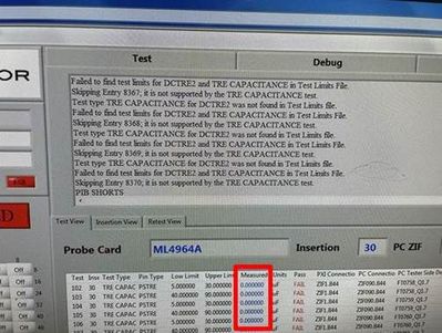

All that error text above your table of values in the first pic suggest that some critical config info was not found in that setup.  Test definitions and limits weren't found, in which case it isn't too surprising (to me, from a distance) that some data is not being captured / measured / reported, causing default 0 values to be displayed.
I wouldn't suspect the hardware until you eliminate config issues as a possible root cause.
-Kevin P
Message 6 of 8
(1,957 Views)

+ other PXI that is perfectly running shows also same error text above table of values
