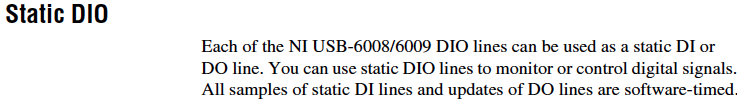

I agree with Dennis. Only AI on the 6008/6009 is hardware timed.  See quote from the User Guide below.
Perhaps AI and some comparisons in software would work for the OP.
Lynn
