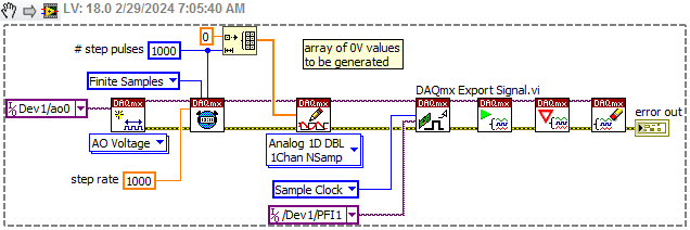

The dummy AO / AI task approach really isn't that difficult.  Here's a simple, possibly ready-to-run example that exports the sample clock from a dummy AO task.  It would be very similar for AI.  See?  There isn't much extra to it, compared to any other task.
-Kevin P

sorry I am little confused.  Using this Ao task can we sample digital channel ?
or to drive stepper motor i can use AO task and spare the counters for encoder position measurements.
Message 7 of 14
(1,847 Views)
Accepted by topic author onlinetouqeer@gmail.com
My suggestion is to use the AO task to drive the stepper (along with a similar AI task for driving it in the other direction), leaving your counters free for the encoder measurement.
-Kevin P
