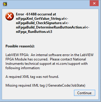

I was compiling the FPGA cRio 9004 but my PC restarted during the compilation, after that an error showed up (-61488). It says that I need to comunicate with the NI support, please tell me what I need to do.

Hi Alex;
You should try out the solution in the following KB
Error -61488 after a LV FPGA Code Comilation Failure
If it doesn't work I would recommend formatting the cRIO in MAX (right click format disc) and reinstalling software
Good luck

Thanks, only I needed to create a new project for the solution.
