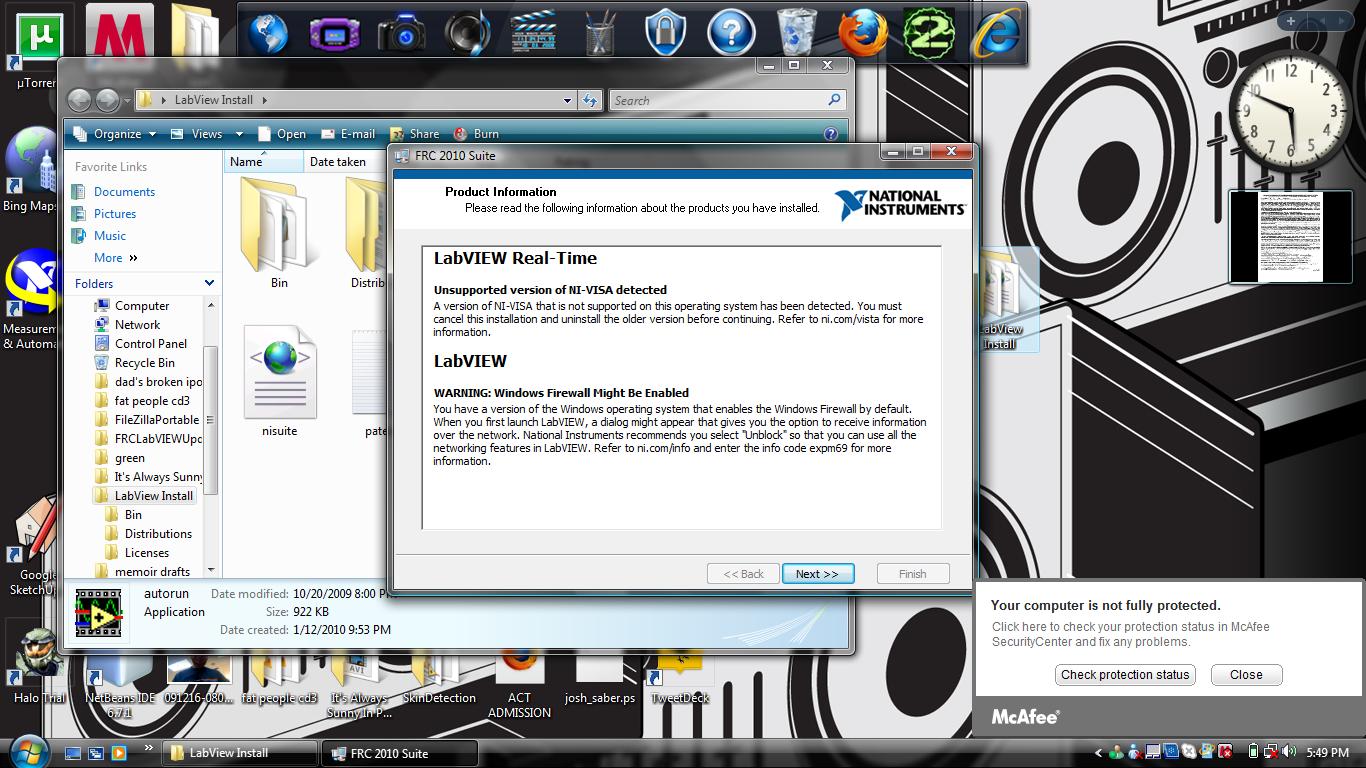

I re-installed LV and i came upon this screen during a part of the nirio installation...  If i skip this, it comes up one more time in a different part.  Does LV FRC support 64 bit?  I disabled the firewall so that isn't theproblem. thanks.problem.jpg

Hello jmanela,
LabVIEW FRC is currently not supported in 64-bit.  It may work and it may not but there was not any testing done for 64-bit.  The only suggestion that I have are to make sure you are running in emulation mode as LabVIEW is a 32-bit application.
Keep in mind, if you don't have another computer to program with, you can always use the Intel Classmate (Driver Station) logged in as the Developer User Account to do your programming.  I do know that the keyboard and screen are pretty small but it already has the development software on it (you just need to run the mandatory updates for LabVIEW and then the Driver Station).
