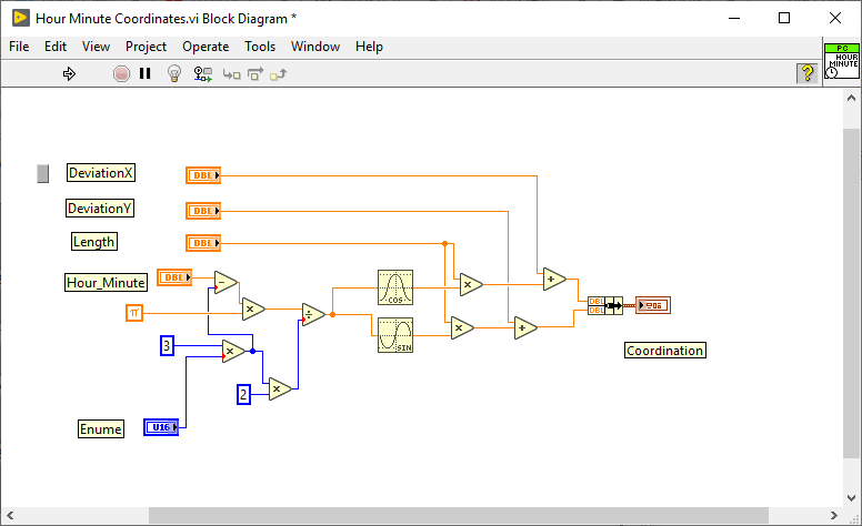

Okay coming back here with another complaint.  Previously I complained that one of my submissions went too far in the changes, now I'm complaining that I see other submissions haven't gone far enough.  I was looking through the idea exchange and through an idea found a Clock XControl.  I made a clock using picture controls years ago so I was curious to see how they did it.  I downloaded the NI Verified and started digging around.  I found a VI that was calculating some stuff so I opened context help and...
Oh...that's odd let me just open the VI.
That's right, no control or terminal labels.  I get that NI Verified doesn't mean it is great awesome code, just that NI did some basic checks on it.  But could "Has Control Labels" be one of the VIA tests they perform on it?  Thanks.
Edit: Oh and I just noticed the way they are drawing the clock means it will continue to use more memory forever.
