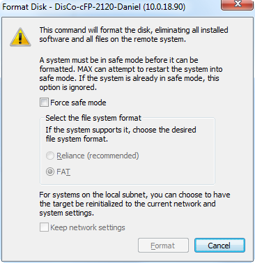

As far as I can tell, there is no way to do that except by formatting the device and checking the option to force safe mode:
I tried changing a few files around with no effect, and I was reluctant to try what you suggesting--just deleting files--for fear of putting the fieldpoint out of action. Why do you want to put the cFP into safe mode? Maybe was can find some way to do that, rather than getting it into safe mode.

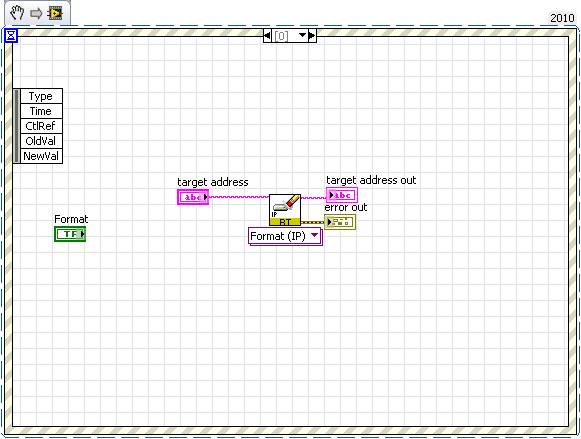

This is the method I use to formatt without being in safe mode. Once this is done, the cFP-2200 controller I execute this on will always boot into safemode.
(7,878 Views)
Ah, I hadn't realized that that VI would automatically force safe mode. Thanks for pointing that out.
(7,871 Views)
The VI does not really "force" safemode. It just formats the drive in a case where MAX would claim safemode is required.
The safemode is just a consequence of the drive being in a formatted state when the RT Target restarts. This is also ideal because I can test and retest my install processes - since I can get the fieldpoint easily back into an unconfigured state.
