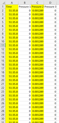

Hey, the date and time issue is fixed thanks. Below are some images of my data/counter/excel rates and then attached is the excel file for the recorded data. You can see in 1 second I only get 2 pressure readings (highlighted)

I posted a plugin here that converts TDMS to CSV with more formatting options:
https://forums.ni.com/t5/FlexLogger/Changing-Time-Logs/m-p/4395317#M878
This allows you to log all TDMS data so it's not resampled. If you do resample the data, there isn't a limit on how on the max sample rate. You can also use relative time and choose the time/date formatting.
