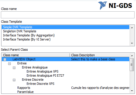

I want to create a new derived GOOP DVR class but GDS does not list some existing GOOP DVR classes as possible parent. How can I fix that?
I can select the class Entree but none of its parents

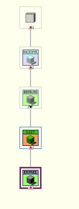

However, the class Entree inherits from other DVR Classes:

Update: After some trials, I concluded that a class MUST be explicitely in the project (not in dependencies) to be in the Select Parent Class list. I find that annoying. Bug or Feature?

That is not the way it is in the native LabVIEW inheritance dialog, hence my confusion. Seriously, I have hundreds of classes in my user library, I don't want to have to include them in my projects just to create derived classes.

I had a similar problem. It could be solved by moving the lvlib containing the classes further up in the project.
