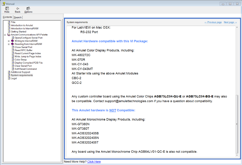

The NI driver for Amulet works with multiple screen sizes. It is built upon the VISA serial driver and and communicates with the display via RS-232.
This is actually documented in their API help when you install the driver. Below is a screenshot:
MK-480272C (The Amulet display that NI sells)
MK-070R
MK-CY-043
MK-CY-043MT
All Starter kits using the above Amulet Modules
CBC-2
GCC-2
The API is only compatible with the above Amulet displays and is not compatible with other screens. Amulet uses a fairly custom protocol on top of serial to send control, indicator and graph data between the host and the display that will not be compatible with other brands.
