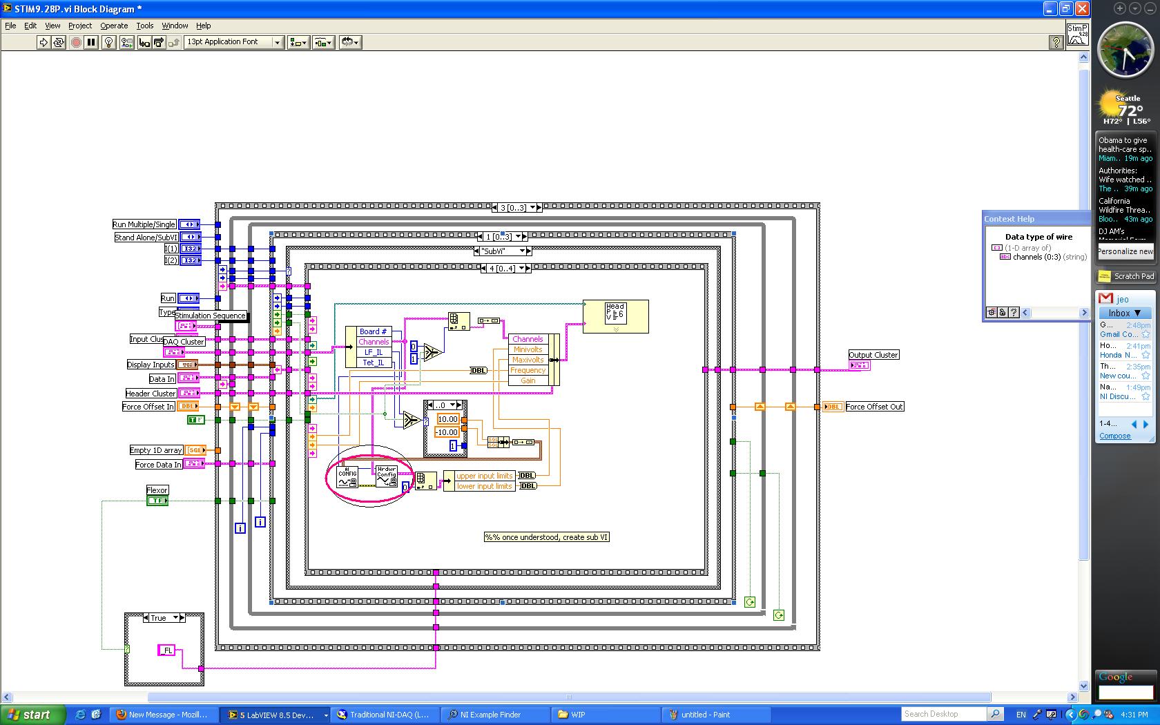

What VI in DAQmx could be substitutable with "Hardware config.VI" in traditional DAQ? I can't find it in DAQmx.
I have a snapshot for my VI below and attachment.

You can get a description of what it does by turning on context help. It looks like it performs about the same function as the DAQmx Create Channel when it's inside a for loop and passed an array of channels.
