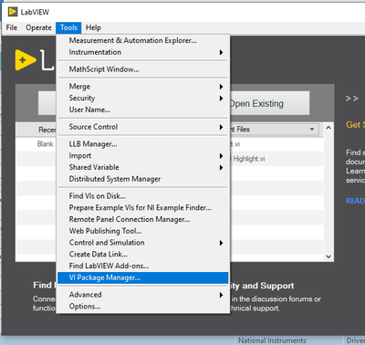

Working on a Labview 2020 system.  Have installed NI-VISA, NI-DAQmx, and LINX via VIPM.  The LINX tool palette shows up, but I don't see the "program/configure" option under the Tools>Labview MakerHub that Remember using in past versions to program an Arduino to be a LINX peripheral.
eg, Labview Makerhub doesn't appear below:

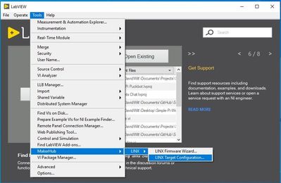

If you are not using LabVIEW 2020 Community what exact edition do you have installed?  I am using LabVIEW 2020 Professional and I see this, which is what you are expecting to see.
MakerHub LINX ToolsMakerHub LINX Tools
If you are using a non-Community edition I have found that you need to install LabVIEW RT 2020 also to get everything to work properly.  I don't remember if the tool showed up before installing LabVIEW RT 2020 so you may want to try that if you are not using the Community edition.

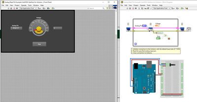

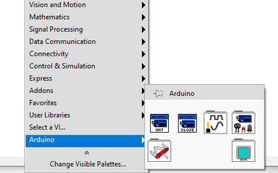

Thanks for the comment.  I'm using Labview Professional 2020 f2.  The MakerHub menu option is the one I'm missing.  Oddly, the Arduino pallette shows up.
and the demo vi's load
