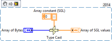

I only read the Assem100 data, which is an array of 11 floating-point numbers (SGL).
EthernetIP CIP Get Attribute Single.vi returns the data as an array of bytes (hex). Use Type Cast to convert the 44 bytes into 11 SGL numbers:
To understand the Type Cast function, see https://forums.ni.com/t5/LabVIEW/I-need-To-Understand-the-quot-Type-Cast-Function-quot/m-p/1462738/h...

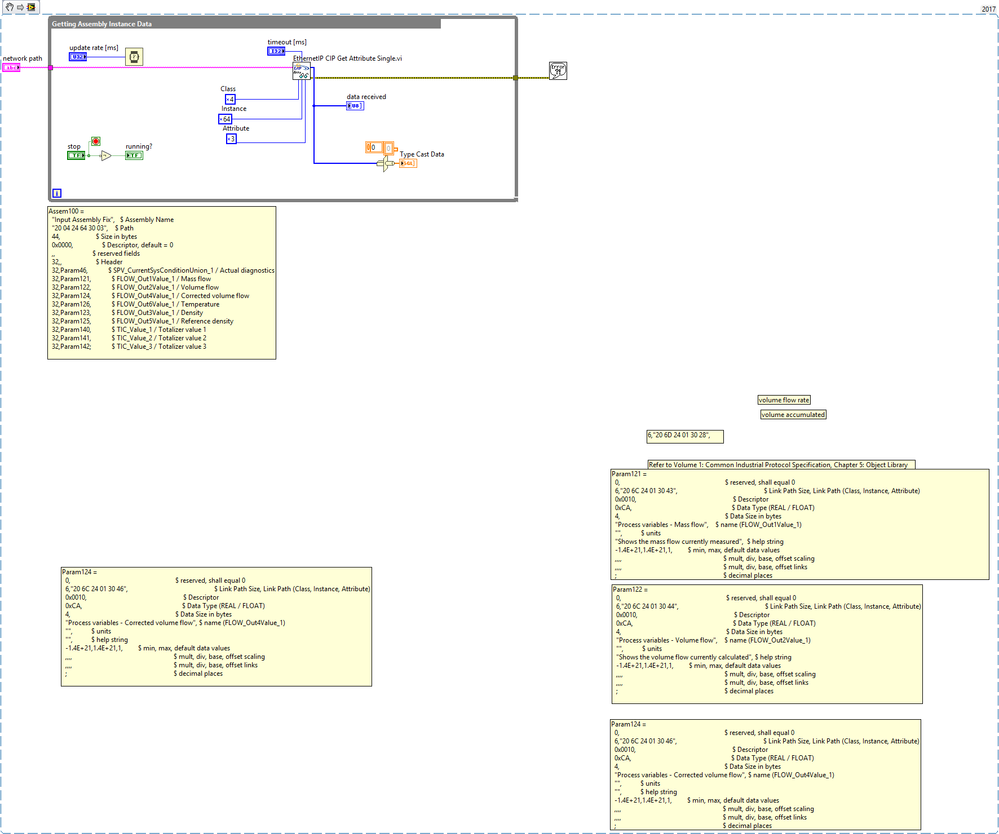

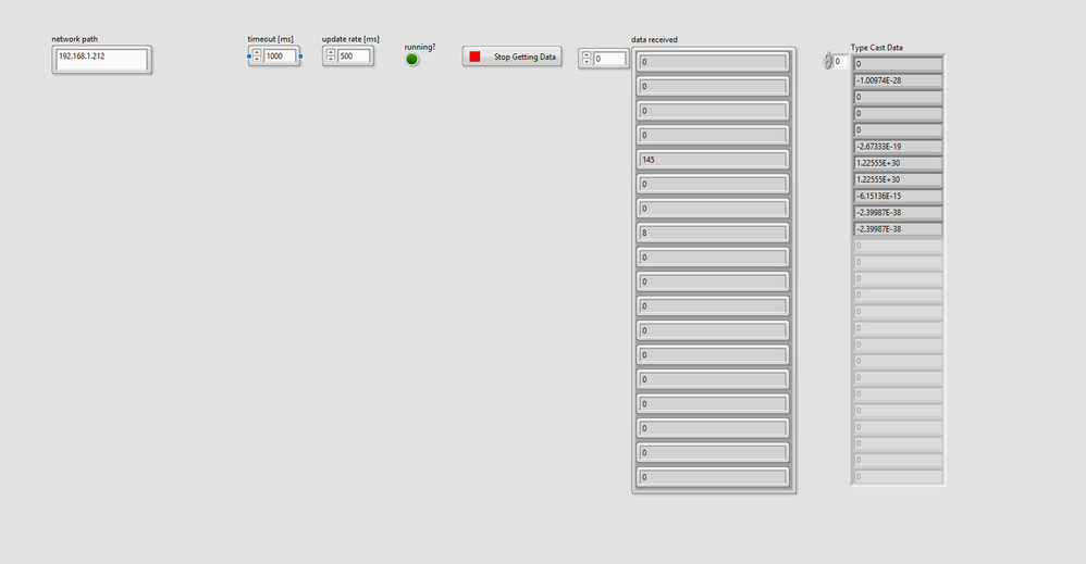

i have attached front panel and block diagram of my code
there are 11 parameters i can converts .
but i have a doubt that not matching with the data which is reading in the device

HI
PLease help anyone how do i match with the display data of Promass 100
