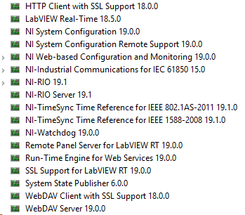

I am using LabVIEW 2018.0f2 and a cRIO-9046 with the following software installed:

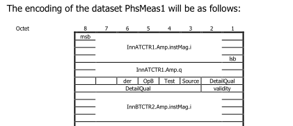

R2.1 section 6.2.3 extends the 61850-7-3 quality field with a "derived" bit, and figure 5 shows the quality bits occupying the lower 13 bits of the quality field.

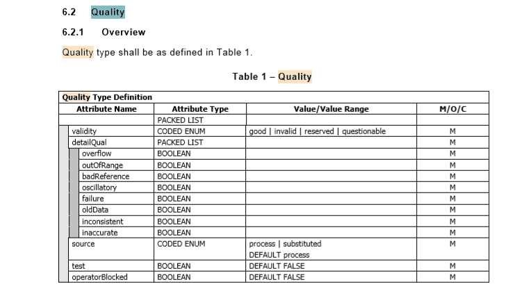

You can get detailed information from NI-Industrial Communications for IEC-61850 Help document. And I also find the related information from the spec of iec 61850-7-3.

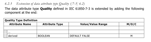

Thank you for your reply. The table you mention in 61850-7-3 does not make any mention of how the various quality flags should actually be encoded into the quality word. 61850-9-2LE specifies a "derived bit" and how the quality field should be encoded.
Is there a way I can support this aspect of 61850-9-2LE with the NI SMV VIs?

I am afraid that NI SMV didn't support the derived bits defined in the 61850-9-2EL. Because NI 61850 is developed based on the third-party's stack. I also checked the reference materials for developing the NI IEC 61850 software. However, these references don't contain the 61850-9-2EL.
