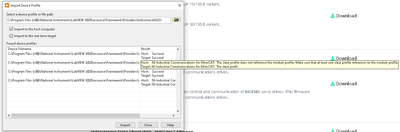

Some of the files gave the following error message when they were attempted to be imported:
One of these problem files is named “DriveDict_0x10142.xml.” Since the 10142 is the slave device we’re connecting to, that could be a problem.

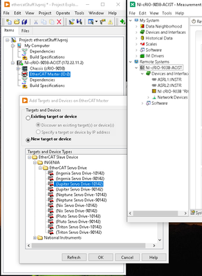

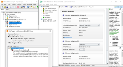

As stated in this document (same as the first link), the XML files have been moved to the C:\Program Files (x86)\National Instruments\LabVIEW XXX\resource\Framework\Providers\indcomecat\DD directory. LabVIEW still says it cannot find the slave device. The error message and setup is shown below:
If I click “New target or device” instead, the correct device shows up:

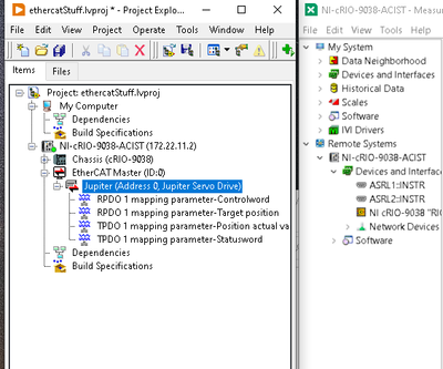

When it’s added, variables show up in the Project Explorer:
However, I can use this method to add other devices (NI 9144) that are definitely not connected to the cRIO. That makes me think that the XML files are there, but the cRIO cannot establish communication with the Jupiter board. Additionally, the Link LED on the Jupiter board that would light up to indicate an established link has never been lit.
