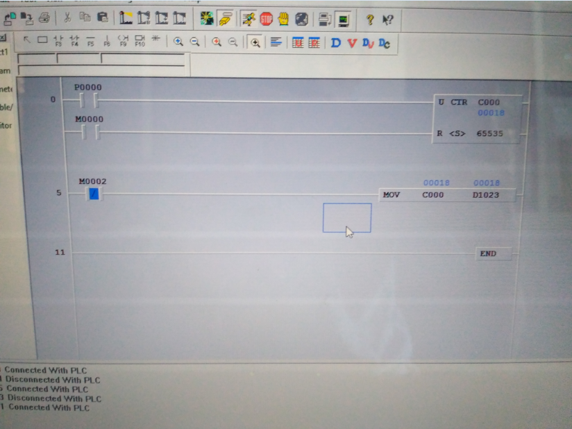

i made program to read the present value of Counter function on my PLC LS K120S(E) via modbusRTU, i have error code  6002
CTR function move to register D1023 that i want to read on myLV,

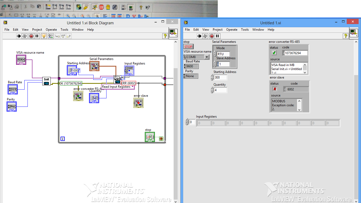

this is my LV program :

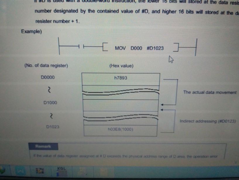

this is the register mapping, am i wrong about the register ?

Hi rhiesnand,
Modbus exception code 2 just means that the data address queried is not allowable on the slave. From what you posted, it looks like your serial settings are not causing the issue.
So, it might just be a matter of making sure you're querying the right register address on the slave.

Did you also tried to read another address and 1 register. Like address 0 ?
You read at 0x3E8 but the screenshot says this is the data at address 0x3FF (1023)

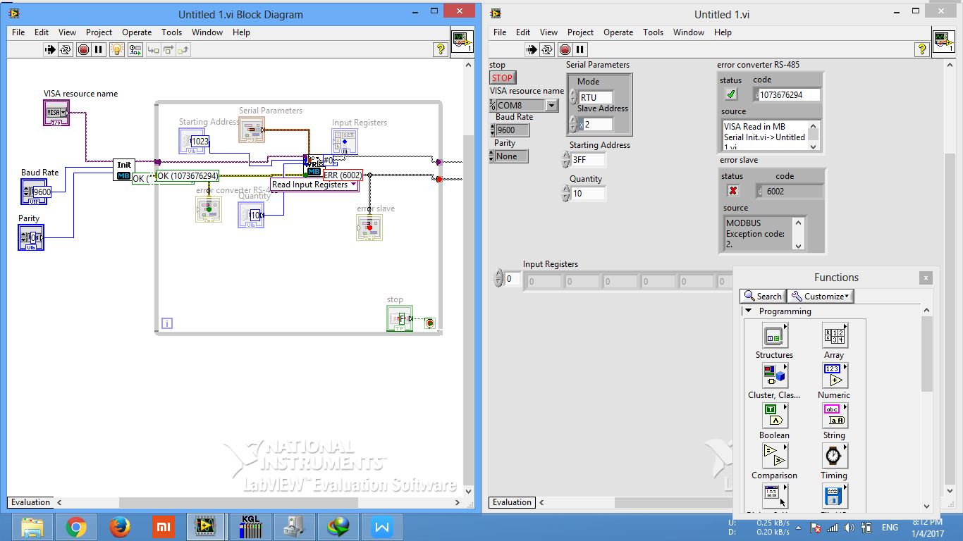

when i read 0 register the connection is good, no error report. i attach my video
https://drive.google.com/open?id=0B_94Z4CwsTYeb0V4OWxSZTV5X2s
i did  it according the manual, the register D1023 is mapping to 0x3E8, but when i change to 0x3FF it gave error code 6002 too.
i attach my vi,hope you can help me to solve this problem,thanks

thanksfor your reply, i did the correct set up on my plc, you can see my  video.
