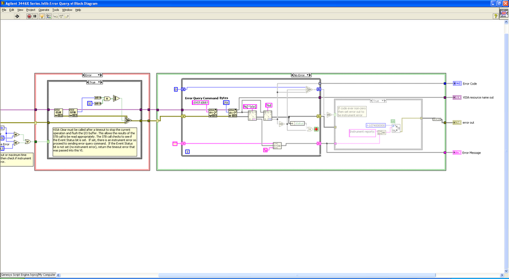

A34465A Error Codes seems to freeze LabVIEW after a few hours of operation.
I never had this before (in the past 3-4 years). We sent out the DMM  for calibration and now it seems to be an issue. LabVIEW freezes (doesn't seem to be stuck in the while loop but stuck at the receive VISA).
Not sure if this is a Driver or Firmware or Harware issue.

That's the odd thing, it doesn't recover at all. It hung all weekend without errors in the front panel or log. It responded correctly to a "Shift" to go into manual. It did multiple batch runs (8 runs of 122 calls to DC Voltage and hung near the end of the 9th run).
I don't think the CAL changed the firmware, as it is still a very old firmware version.
I remember having to contact NI to get drivers for LV2011.
I can check for a name change, but my software uses the IDN to identify which drivers to take and takes the correct one as the library name on the title bar of the screenshot.
It's hard to debug as it happens after a long time running.
Zipped the drivers. The error happens in the Error Code.

Minions is suggesting to add a ";" to the ":SYST:ERR?" command where you see the hang.  That's a good point.  How many times does that while loop iterate before it hangs?  Perhaps add a counter as well.
I re-read that little note in the BD before the ":SYST:ERR?" command check.  That CLR might be the issue, it sounds like a kludge.  Whenever I have to resort to a CLR to make things work I typically add a little delay after a CLR.  So perhaps a 1s delay might also be in order.
Make a modified Error Check.VI and replace the existing one, put that in a tight loop and see if your debugging doesn't come up with something.

I think I solved it, at least it hasn't frozen since.
I swapped (Make This Case Error) the condition of the main Error Case to execute the SYS:ERR? if there's an error at the input rather than doing it for each command.
The CLR wasn't the issue (although I left the 1000ms delay between the CLR and STB in the final implementation).
